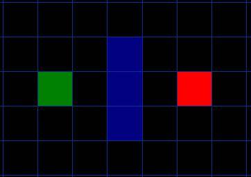

Let's assume we have someone who wants to get from point A to point B and that a wall separates the two points. This is illustrated in the graphic found below, with green being the starting point A, red being the ending point B, and the blue filled squares being the wall in between.
我们假设某人想从A点到达B点,一堵墙把它们分开了。如下图所示,绿色是开始点A,红色是结束点B,而蓝色填充的方块是中间的墙。
[图 1][Figure 1]
The first thing you should notice is that we have divided our search area into a square grid. Simplifying the search area, as we have done here, is the first step in pathfinding. This particular method reduces our search area to a simple two dimensional array. Each item in the array represents one of the squares on the grid, and its status is recorded as walkable or unwalkable. The path is found by figuring out which squares we should take to get from A to B. Once the path is found, our person moves from the center of one square to the center of the next until the target is reached.
你应该注意的第一件事是,我们把搜索区域分割成了方块的格子。简化搜索区域,如你目前完成的那样,这是寻路的第一步。这个特殊方法把搜索区域简化成了一个二维数组。数组的每一个项目代表了格子里的一个方块,它的状态记录成可行走和不可行走。通过计算出从A到达B应该走哪些方块,就找到了路径。一旦路径找到,我们的人从一个方块的中心移动到下一个方块的中心,直到抵达目标。
These center points are called "nodes". When you read about pathfinding elsewhere, you will often see people discussing nodes. Why not just refer to them as squares? Because it is possible to divide up your pathfinding area into something other than squares. They could be rectangular, hexagons, or any shape, really. And the nodes could be placed anywhere within the shapes ? in the center or along the edges, or anywhere else. We are using this system, however, because it is the simplest.
这些中心点称作“节点”。当你在其它地方阅读关于寻路时,你将经常发现人们讨论节点。为什么不直接把它们认为是方块呢?因为有可能你要把你的寻路区域以非方块的东西来分割。它们可能是矩形,六角形,或任何形状,真的。而节点可以放到形状内的任何位置。在中心,或者沿着边缘,或其它地方。然而我们使用这个系统,因为它最简单。

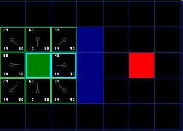

At this point, you should have something like the following illustration. In this diagram, the dark green square in the center is your starting square. It is outlined in light blue to indicate that the square has been added to the closed list. All of the adjacent squares are now on the open list of squares to be checked, and they are outlined in light green. Each has a gray pointer that points back to its parent, which is the starting square.
在此,你应该有了类似下图的东西。在这个图中,中间的深绿色的方块就是开始方块。它有浅蓝色的外框,表示它被添加到封闭列表了。所有的相邻方块现在都进入要检查的方块的开放列表中了,它们有浅绿的外框。每一个都有灰色的指针指回它的父亲,它就是开始方块。
[图 2][Figure 2]
Next, we choose one of the adjacent squares on the open list and more or less repeat the earlier process, as described below. But which square do we choose? The one with the lowest F cost.
下一步,我们从开放列表中,选出一个相邻的方块,然后多多少少重复早先的过程,下面会说到。但是我们选择哪一个呢?具有最小F值的那个。

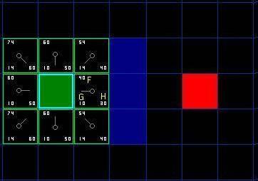

[图 3][Figure 3]
So let's look at some of these squares. In the square with the letters in it, G = 10. This is because it is just one square from the starting square in a horizontal direction. The squares immediately above, below, and to the left of the starting square all have the same G score of 10. The diagonal squares have G scores of 14.
好,让我们来观察某些方块。在有字母的方块中,G = 10。这是由于在水平方向上从开始点(到那里)只有一个方块(的距离)。开始点相邻上方,下方和左边的方块都具有同样的G值:10。斜角的方块G值为 14。
The H scores are calculated by estimating the Manhattan distance to the red target square, moving only horizontally and vertically and ignoring the wall that is in the way. Using this method, the square to the immediate right of the start is 3 squares from the red square, for a H score of 30. The square just above this square is 4 squares away (remember, only move horizontally and vertically) for an H score of 40. You can probably see how the H scores are calculated for the other squares.
H的计算通过估算Manhattan距离而得,即:水平/垂直移动,忽略途中的障碍,到达红色的目标方块的距离。用这种方法,开始点相邻右边的方块和红色方块相距3个方块,那么H值就是30。其上的方块距离为4(记住,只能水平或者垂直移动),H就是40。你也许可以看看其他方块的H值是如何算出的。
The F score for each square, again, is simply calculated by adding G and H together.
每个方块的F值,再说一下,不过就是G和H相加。

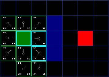

Okay, so let's see how this works. Of our initial 9 squares, we have 8 left on the open list after the starting square was switched to the closed list. Of these, the one with the lowest F cost is the one to the immediate right of the starting square, with an F score of 40. So we select this square as our next square. It is highlight in blue in the following illustration.
好了,让我们看看它是怎样工作的。在初始的9个方块中,当开始方块被纳入封闭列表后,我们的开放列表就只有8个方块了。在这些块中,具有最小F值的是开始方块相邻右边的那个,其F值为40。所以我们选定这个块作为下一个方块。在随后的图例中,它以高亮的蓝色表示。
[图 4][Figure 4]
First, we drop it from our open list and add it to our closed list (that's why it's now highlighted in blue). Then we check the adjacent squares. Well, the ones to the immediate right of this square are wall squares, so we ignore those. The one to the immediate left is the starting square. That's on the closed list, so we ignore that, too.
首先,我们把它从开放列表取出,并加入到封闭列表(这就是它现在是高亮的蓝色的原因)。然后我们检查相邻的方块。然而,这个方块相邻右边的是代表墙的方块,所以忽略它们。其相邻左边是开始方块。它处于封闭列表内,所以也忽略它
The other four squares are already on the open list, so we need to check if the paths to those squares are any better using this square to get there, using G scores as our point of reference. Let's look at the square right above our selected square. Its current G score is 14. If we instead went through the current square to get there, the G score would be equal to 20 (10, which is the G score to get to the current square, plus 10 more to go vertically to the one just above it). A G score of 20 is higher than 14, so this is not a better path. That should make sense if you look at the diagram. It's more direct to get to that square from the starting square by simply moving one square diagonally to get there, rather than moving horizontally one square, and then vertically one square.
其它4个已经在开放列表中了,所以我们需要检查经由当前方块到达他们是否是更优的路径,使用G值为参考点。我们来看看这个选定方块上面右边的那个方块。它的当前G值是14。如果我们经由当前方块到达那里,G值将是20(10,到达当前方块的G值,再加上10垂直移动到它上面的方块)。20 > 14,所以这不是一个好的路径。看看图解能更好的理解这些。从开始方块斜向移动到那个方块更直接,而不是水平移动一个方块,再垂直移动一个方块。
When we repeat this process for all 4 of the adjacent squares already on the open list, we find that none of the paths are improved by going through the current square, so we don't change anything. So now that we looked at all of the adjacent squares, we are done with this square, and ready to move to the next square.
当我们对已经存在于开放列表的所有4个相邻方块都重复这个过程,我们发现经由当前方块没有更佳的路径,所以什么也不用改变。现在看看所有的相邻方块,我们已经处理完毕,并准备移动到下一个方块。
So we go through the list of squares on our open list, which is now down to 7 squares, and we pick the one with the lowest F cost. Interestingly, in this case, there are two squares with a score of 54. So which do we choose? It doesn't really matter. For the purposes of speed, it can be faster to choose the last one you added to the open list. This biases the search in favor of squares that get found later on in the search, when you have gotten closer to the target. But it doesn't really matter. (Differing treatment of ties is why two versions of A* may find different paths of equal length.)
现在,我们再遍历开放列表,它只有7个方块了,选择具有最小F值的那个。有趣的是,此时有两个方块都有值54。那么我们选择哪个?实际上这不算什么。为了速度的目的,选择你最后加入到开放列表的那个方块更快。当你更接近目标的时候,它倾向于后发现的方块。但这真的没什么关系。(不同的处理造成了两个版本的A*可能找到不同的等长路径。)

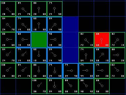

So let's choose the one just below, and to the right of the starting square, as is shown in the following illustration.
我们选择下面的那个,位于开始方块的右边,如下图所示。
[图 5][Figure 5]
This time, when we check the adjacent squares we find that the one to the immediate right is a wall square, so we ignore that. The same goes for the one just above that. We also ignore the square just below the wall. Why? Because you can't get to that square directly from the current square without cutting across the corner of the nearby wall. You really need to go down first and then move over to that square, moving around the corner in the process. (Note: This rule on cutting corners is optional. Its use depends on how your nodes are placed.)
这一次,当检查相邻的方块时,我们相邻右边的是一个墙方块,所以忽略它。对那个方块上面的块同样忽略。我们也忽略墙下面的方块。为什么?因为你不把临近墙的角切开就无法直接到达那个方块。实际上你需要先向下走,然后越过那个方块,在这个过程中都是围绕角在移动。(说明:切开角的规则是可选的。它的使用依赖于你的节点如何放置。)
That leaves five other squares. The other two squares below the current square aren't already on the open list, so we add them and the current square becomes their parent. Of the other three squares, two are already on the closed list (the starting square, and the one just above the current square, both highlighted in blue in the diagram), so we ignore them. And the last square, to the immediate left of the current square, is checked to see if the G score is any lower if you go through the current square to get there. No dice. So we're done and ready to check the next square on our open list.
这样就剩下5个方块了。当前方块下的两个方块不在开放列表中,所以要添加他们,并把当前方块作为它们的父亲。在另外三个方块中,有两个已经在封闭列表中了(开始方块,和当前方块上面的那个,它们都用高亮的蓝色在图中标出来了),所以忽略它们。最后一个方块,当前方块相邻左边的那个,检查经由当前方块到达那里是否得到更小的G值。没有。所以处理完毕,并准备检查开放列表中的下一个方块。

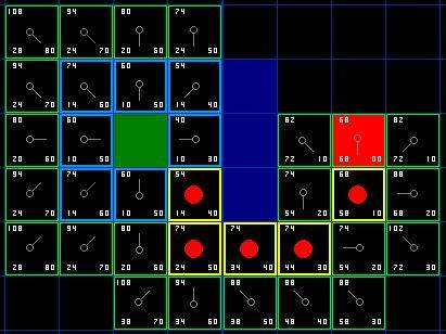

We repeat this process until we add the target square to the open list, at which point it looks something like the illustration below.
我们重复这个过程,直到把目标点添加到开放列表,此时的情形如下图所示。
[图 6][Figure 6]
Note that the parent square for the square two squares below the starting square has changed from the previous illustration. Before it had a G score of 28 and pointed back to the square above it and to the right. Now it has a score of 20 and points to the square just above it. This happened somewhere along the way on our search, where the G score was checked and it turned out to be lower using a new path ? so the parent was switched and the G and F scores were recalculated. While this change doesn't seem too important in this example, there are plenty of possible situations where this constant checking will make all the difference in determining the best path to your target.
注意开始方块向下的第二个方块,在前面的描述中其父亲已经发生改变。开始它的G值为28,指向其右上角的方块。现在它的值是20,指向其上方的方块。这是在搜索方法中某处发生的吗?在那里G值被检查,而且使用新的路径后,它得到了更小的值。所以它的父亲切换了,G和F也重新计算。而这个改变在本例中不见得非常重要,还有足够多的可能位置,在决定最佳路径的时候,持续的检查会产生各种差别。
So how do we determine the actual path itself? Simple, just start at the red target square, and work backwards moving from one square to its parent, following the arrows. This will eventually take you back to the starting square, and that's your path! It should look like the following illustration. Moving from the starting square A to the destination square B is simply a matter of moving from the center of each square (the node) to the center of the next square on the path, until you reach the target. Simple!
那么我们怎样决定实际的路径呢?简单,从红色目标方块开始,向后移动到它的父亲,跟从箭头的指示。最终你会回到开始方块,这就是路径!它应该如下图所示。从方块A移动到目标方块B就是从每一个方块(节点)的中心移动到路径上的下一个方块的中心的简单过程,直到到达目标。简单!
